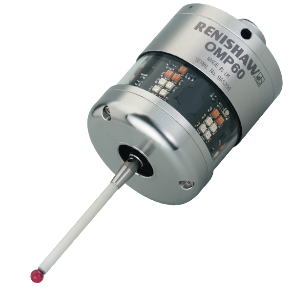

OMP60 probe kit including batteries and tool kit.
Compact 3D touch-trigger probe with optical signal transmission. Used for workpiece set-up inspection on a wide range of medium and large machining centres. Compatibility with all Renishaw optical receivers enables users to easily upgrade existing installations.
Probe switch-on / switch-off methods are user configurable. The factory-default setting of optical on / optical off can be modified to optical on / timer off (timeout), spin on / spin off, spin on / timer off (timeout), or shank switch on / shank switch off if required.
Note: This kit does not contain a stylus.
Technical table
Transmission typeOptical
Key features and benefits:
• Proven kinematic design
• Exceptional resistance to light interference with modulated transmission
• 360° transmission envelope
• Compact design
• Various activation options and adjustable trigger force
• 1.00 µm 2σ repeatability
