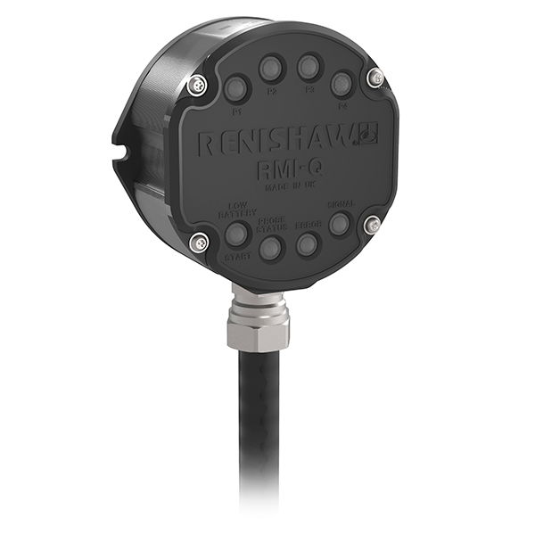

This RMI-Q interface includes a 15 m side exit cable and tool kit.
A combined transmitter, receiver and interface unit that enables individual radio turn on and operation of up to four separate Renishaw radio probes. This permits numerous combinations of radio probes and/or radio tool setters to be used on the same machine tool. It is designed to be mounted anywhere within the machine’s working envelope, resulting in a quick and simple installation. Unlike the optical transmission systems, line-of-sight between the probe and receiver is not necessary.
Use of the RMI-Q with multiple Renishaw radio probes is ideal for retrofitting to existing machines.
Technical table
Transmission typeRadio
Key features and benefits:
• Up to four probes with one interface and receiver unit
• Globally available 2.4 GHz frequency band – compliant with radio regulations in all major markets
• Frequency hopping spread spectrum (FHSS) transmission
• Negligible interference from other radio sources means consistent and reliable performance
• Multiple Renishaw radio probes will co-exist within the widest machining environment
• Robust, long-range communications make RMI-Q ideal for larger machines
