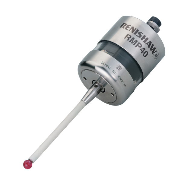

RMP40 QE probe kit including batteries and tool kit.
The RMP40 QE is a standard-accuracy touch-trigger probe for automated workpiece set-up and inspection.
The robust transmission protocol and small body make the RMP40 the ideal choice for multi-tasking applications where the line-of-sight between probe and interface cannot always be maintained.
The RMP40 QE probe is compatible with RMI-QE and RMI-Q interfaces. It is not compatible with the RMI interface.
Probe switch-on / switch-off methods are user configurable. The factory-default setting of radio on / radio off can be modified to radio on / timer off (timeout), spin on / spin off, or spin on / timer off (timeout) if required.
Note: This kit does not contain a stylus.
Technical table
Transmission typeRadio
Key features and benefits:
• Proven kinematic design
• Secure frequency hopping spread spectrum (FHSS)
• Globally recognised 2.4 GHz waveband compliant with radio regulations in all major markets
• Ultra-compact design
• Increased environmental protection
• 1.00 µm 2σ repeatability
• Provides an increase of up to 400% in battery life compared with previous generation probes
