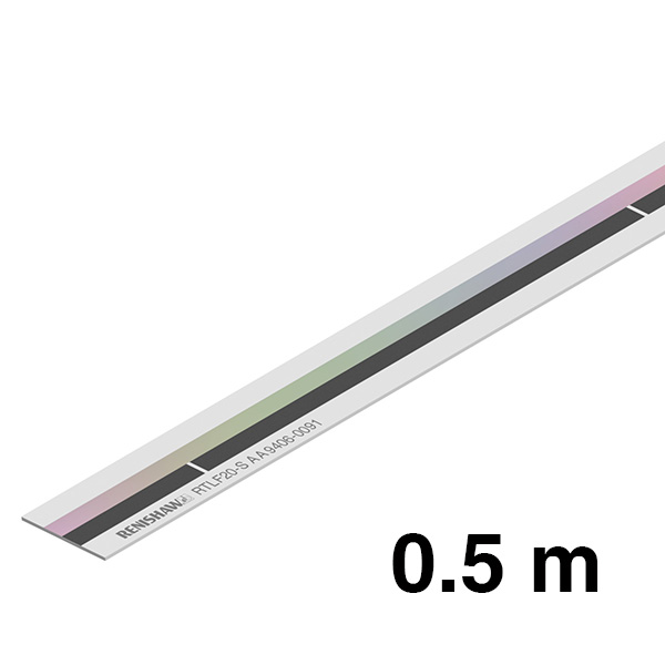

RTLF incremental 20 μm pitch linear scale (500 mm length, ±5 μm/m accuracy) Product code: A-9406-0050 RTLF20-S annotated 0.5 mNo description available[0B] RTLF20-S annotated 0.5 m No description available [0B] Price: $254.00 All prices are ex sales tax Limited AvailabilityLonger lead times may apply.Contact us for more information. Add to new group Before you begin to add items to your favourites please create your first group: A favourites group name can only be 1-80 alphanumeric characters and must not begin with white space Product sucessfully added to View favourites Processing request A-9406-0050 is a 0.5 m (500 mm) length of RTLF20-S incremental encoder tape scale, compatible with ATOM and ATOM DX encoder readheads (for 20 µm ATOM DX readheads, contact your local Renishaw representative). RTLF20-S is a 20 µm pitch low-profile stainless steel tape scale.RTLF20-S is applied to the substrate with self-adhesive backing tape, which is formulated to enable the scale to expand independently of the machine substrate. To complete the installation, the scale is clamped at one point to provide a datum position. Technical tableAccuracy (± µm)5Coefficient of thermal expansion10.1 µm/m/°CLength (mm)500MaterialStainless steelMount typeSubstrate independentScale length (m)500Scale pitch (µm)20Scale typeTape RTLF20-S Features / benefits: Quick and simple application using Renishaw's scale applicator Low-profile stainless steel tape scaleCustomer deselectable reference marks every 50 mmCut-to-length flexibility High solvent immunity Compatible readheads:ATOM and ATOM DX readheadsAvailable online:ATOM ATOM2D0-100 For more details on this and other Renishaw encoder scales please visit our scales page. Shopping security Recall your cart
