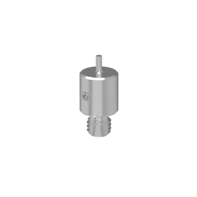

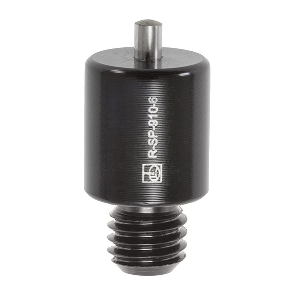

Ø9 mm × 10 mm steel pin standoff with M6 thread Product code: R-SP-910-6 Ø9 mm x 10 mm steel pin standof with M6 threadThis steel pin standoff is used to elevate and locate a part against the pin.[0B] Ø9 mm x 10 mm steel pin standof with M6 thread This steel pin standoff is used to elevate and locate a part against the pin. [0B] Price: $15.25 All prices are ex sales tax Call for availability +1 847 286 9953 Add to new group Before you begin to add items to your favourites please create your first group: Product sucessfully added to View favourites Processing request This steel standoff is ideal to elevate and locate parts. It is manufactured from heat treated steel with a black nitride coating that gives excellent corrosion resistance and improved durability. It is recommended for use on CMMs, the Equator™ gauging system, and vision and multi-sensor machines. Technical tableDiameter (mm)9Diameter (in)0Height (mm)10Height (in)0MaterialSteelMeasurement systemMetricPin diameter (mm)1.6Pin height (mm)2.5ThreadM6 Technical documentation N-R-SP-910-6-A N-R-SP-910-6-A Web shop drawing [0B] Related products $15.25 Ø12 mm × 10 mm aluminium pin standoff with M4 thread $16.25 Ø13 mm × 25 mm steel pin standoff with M6 thread $16.25 Ø13 mm × 25 mm steel pin standoff with M8 thread $15.25 Ø6 mm × 10 mm steel pin standoff with M6 thread $15.75 Ø9 mm × 10 mm steel pin standoff with M4 thread Shopping security Recall your cart
