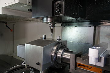

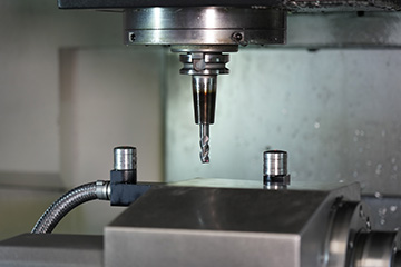

Low-volume production (LVP) machinists are responsible for the complete manufacturing process for new components, from introducing a new CAM process, to setting and running the machines.
Typically, we'll create a new process within an eight‑hour shift, which includes using CAM software to create a new piece part program, setting the machine, and manufacturing the piece parts within these tight timescales. To achieve efficient processes with short lead times, we have to ensure our machines are in the best possible condition, which we do by carrying out regular health checks using Renishaw's QC20 ballbar system. We rely heavily on Renishaw products to help maintain healthy machines we know are reliable and can produce correct components first time, every time.

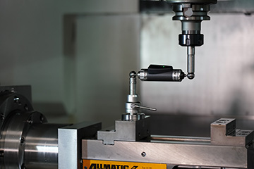

  • Performance checks: machine calibration, using the QC20 ballbar kit (multiple processes)
  • Health check procedure: using an OMP400 spindle probe (on a vertical mill process)
  • Error mapping work co-ordinates: using an OMP400 spindle probe (on a mill/turn process)
  • Turret-to-turret tool datuming: using an OLP40 probe and stylus assembly (on a mill/turn process)

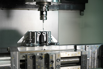

AS: This comes down to a combination of efficiency and reducing the cost of quality. We can use probing technologies to find the positions of features, and to ensure features are cut to size accurately. Some large components can take several hours to machine across multiple operations, and rejecting a component because a feature is either out of position or not the right size is neither efficient nor cost effective. Introducing simple probing cycles can prevent this and targets key departmental metrics.

I've been targeting the error mapping of machinery to ensure the first component is correct without adding to the initial process development time. One example of how we've achieved this involved a machine with extremely poor set time performance.
  • Complex large mill turn machine with dual spindle, B-Axis and turret.
  • This caused multiple position errors in the machine.
  • Without knowing these positional errors, it would lead to poor set performance on average of eight hours per set (often more than this) to run small/low-volume batch sizes.
  • Inefficiencies on this workcentre were regularly leading to supply issues.
  • Implementation of Renishaw's OMP400 spindle probing has allowed us to find positional errors in the machine between axes and help implement an error-mapping procedure.
  • This health check is performed bi-weekly to ensure machine positional errors are found and stored in the macros, which are then called back into each new machine set-up incorporated through the machine work co-ordinates.
  • This process, along with the additional turret-to-turret tool datuming, means complete accuracy between all the machine's axes – error mapping the machine.
  • Average set times have now been halved and the impact on savings, in terms of production time and cost of quality, is extremely rewarding.
