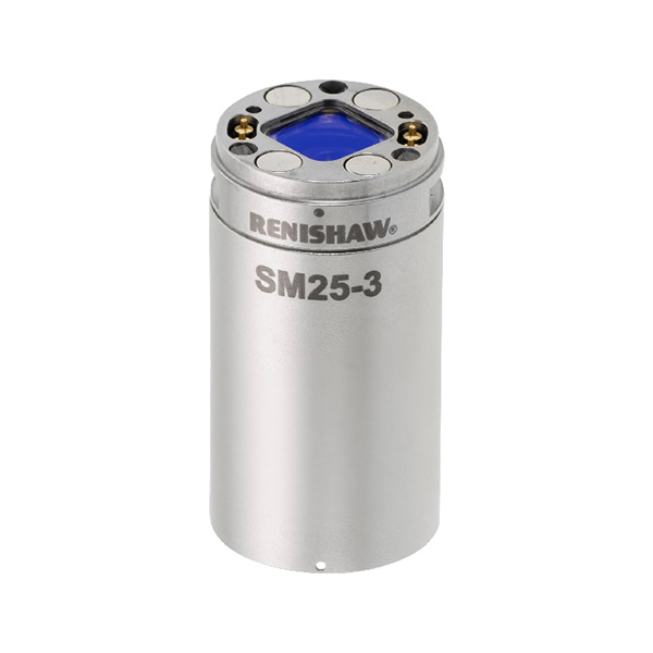

SM25-3 scanning module only
Product code: A-2237-1113
  • SM25-3
Price: $5,094.00
All prices are ex sales tax
Stocked item
Normally dispatched within 2 working days
Processing request
The SP25M comprises two sensors in a single housing. Users can switch between a choice of five scanning modules (which can carry M3 styli with lengths from 20 mm to 400 mm) and an adaptor module that is compatible with Renishaw's TP20 range of probe modules. This capability enables scanning and touch-trigger probing in a single probe system.
The SP25M's compact size and autojoint mounting makes it compatible with the PH10M PLUS / PH10MQ PLUS and PH6M probe heads. It can also be mounted on a multiwired extension bar. Together, these combinations permit excellent reach and access to part features.
Using SP25M as a scanning probe
Range of modules designed to provide optimised scanning performance over their specified stylus length ranges:
  • SM25-1 / 2 / 3 / 4 recommended for use with linear stylus arrangements
  • SM25-5 recommended for use with non-linear and star stylus arrangements
Using SP25M as a touch-trigger probe
  • TM25-20 TTP adaptor module (to carry TP20 modules)
  • For rapid touch-trigger measurements
  • Compatible with the full range of TP20 stylus modules
