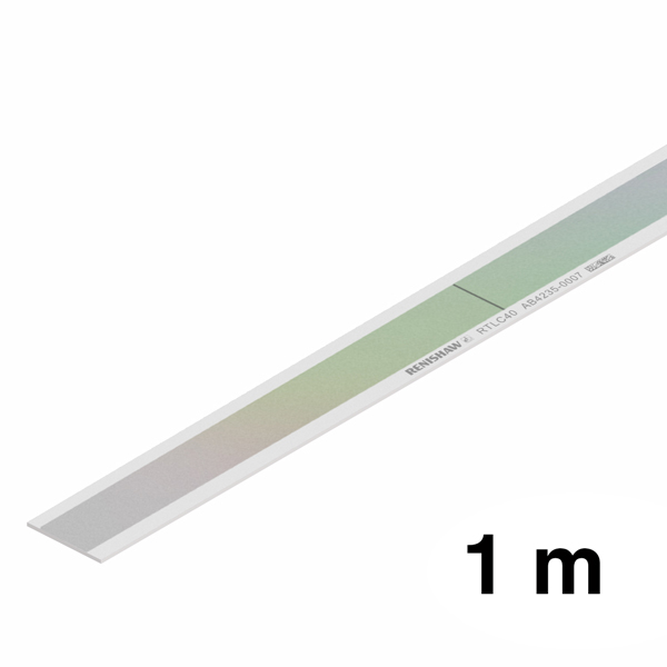

A-6567-0100 is a 1 m (1000 mm) length of RTLC40-S incremental encoder tape scale, compatible with QUANTiC encoder readheads.
RTLC40-S is a 40 µm pitch low-profile stainless steel tape scale.
RTLC40-S is applied to the substrate with self-adhesive backing tape, which is formulated to enable the scale to expand independently of the machine substrate. To complete the installation, the scale is clamped at one point to provide a datum position.
Technical table
Accuracy (± µm)15
Coefficient of thermal expansion10.1 µm/m/°C
Length (mm)1000
MaterialStainless steel
Mount typeSubstrate independent
Scale length (m)1000
Scale pitch (µm)40
Scale type8 mm wide x 0.2 mm thick flexible stainless steel tape (CTE: 10.1 ±0.2 μm/m/°C)
RTLC40-S Features / benefits:
•    Quick and simple application using Renishaw's scale applicator
•    Low-profile stainless steel tape scale
•    Customer selectable IN-TRAC™ reference mark every 50 mm
•    Cut-to-length flexibility
•    High solvent immunity
