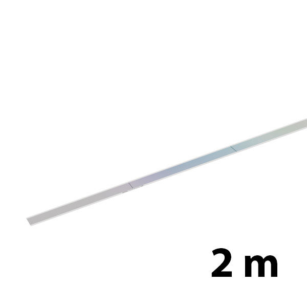

RKLC20-S linear or partial arc encoder tape scale (20 µm scale pitch for VIONiC™ and TONiC™ readheads) Product code: A-6663-0200 RKLC20-S 2 m (annotated)A-6663-0200[0B] RKLC20-S 2 m (annotated) A-6663-0200 [0B] Price: $963.00 All prices are ex sales tax Limited AvailabilityLonger lead times may apply.Contact us for more information. Add to new group Before you begin to add items to your favourites please create your first group: A favourites group name can only be 1-80 alphanumeric characters and must not begin with white space Product sucessfully added to View favourites Processing request A-6663-0200 is a 2 m (2000 mm) length of RKLC20-S incremental encoder tape scale, compatible with VIONiC and TONiC encoder readheads.RKLC20-S is a 20 µm pitch narrow low-profile stainless steel tape scale.RKLC20-S is applied with self-adhesive backing tape and mastered to the machine substrate using rigidly fixed end clamps.Can be used in linear or partial arc applications. Technical tableAccuracy (± µm)5Coefficient of thermal expansionMatches that of substrate (when end clamps used)Length (mm)2000MaterialStainless steelMount typeSubstrate masteredScale length (m)2000Scale pitch (µm)20Scale typeNarrow Tape RKLC20-S Features / benefits:Quick and simple application using Renishaw's scale applicator Narrow, low-profile, highly flexible stainless steel tape scaleFor linear or partial arc applications with a minimum radius of 30 mmCustomer selectable IN-TRAC™ reference mark every 50 mmCut-to-length flexibility High solvent immunity Compatible readheads:VIONIC and TONiCAvailable online:VIONiC V2BCY30D20AVIONiC V2BCX10D08ATONiC T1030-15A For more details on this and other Renishaw encoder scales please visit our scales page Related products $38.00 Scale applicator for RKLC self-adhesive scales with TONiC™, VIONiC™ or QUANTiC™ encoder readheads $22.00 Encoder scale end clamp kit for RKL encoder scale installation $23.00 IPA wipes for all encoder system installations (pack of 20) $5.00 RGG-2 epoxy adhesive (sachet) $422.00 Guillotine for cutting RKL and RTL linear encoder scales $191.00 Shears for cutting RKL and RTL linear encoder scales $67.00 Replacement blades for scale shears Shopping security Recall your cart
