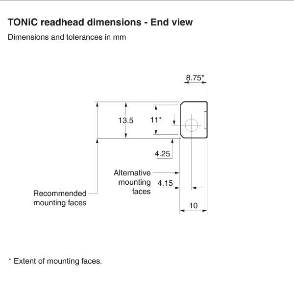

T1030-15A is a standard Renishaw TONiC readhead with a 1.5 m cable length, configured for a linear encoder system using Renishaw RTLC20-S or RKLC20-S scale.
When combined with the detachable Ti interface Ti0000A00A, it provides ultimately reliable precision feedback and high-speed performance, with easy installation, analogue output, low Sub‑Divisional Error (SDE) and noise.

  • TONiC readheads are simple to install with wide set-up tolerances and calibration at the push of a button
  • Dynamic signal control and unique filtering optics ensures low SDE and noise, maintains signal amplitude and enables improved scanning performance and positional stability
  • An optional TONiC diagnostic kit is available for real‑time encoder data feedback during installation or for in-field diagnostics (contact your local Renishaw representative)
  • A CAD model of the TONiC readhead is available from the Renishaw website
