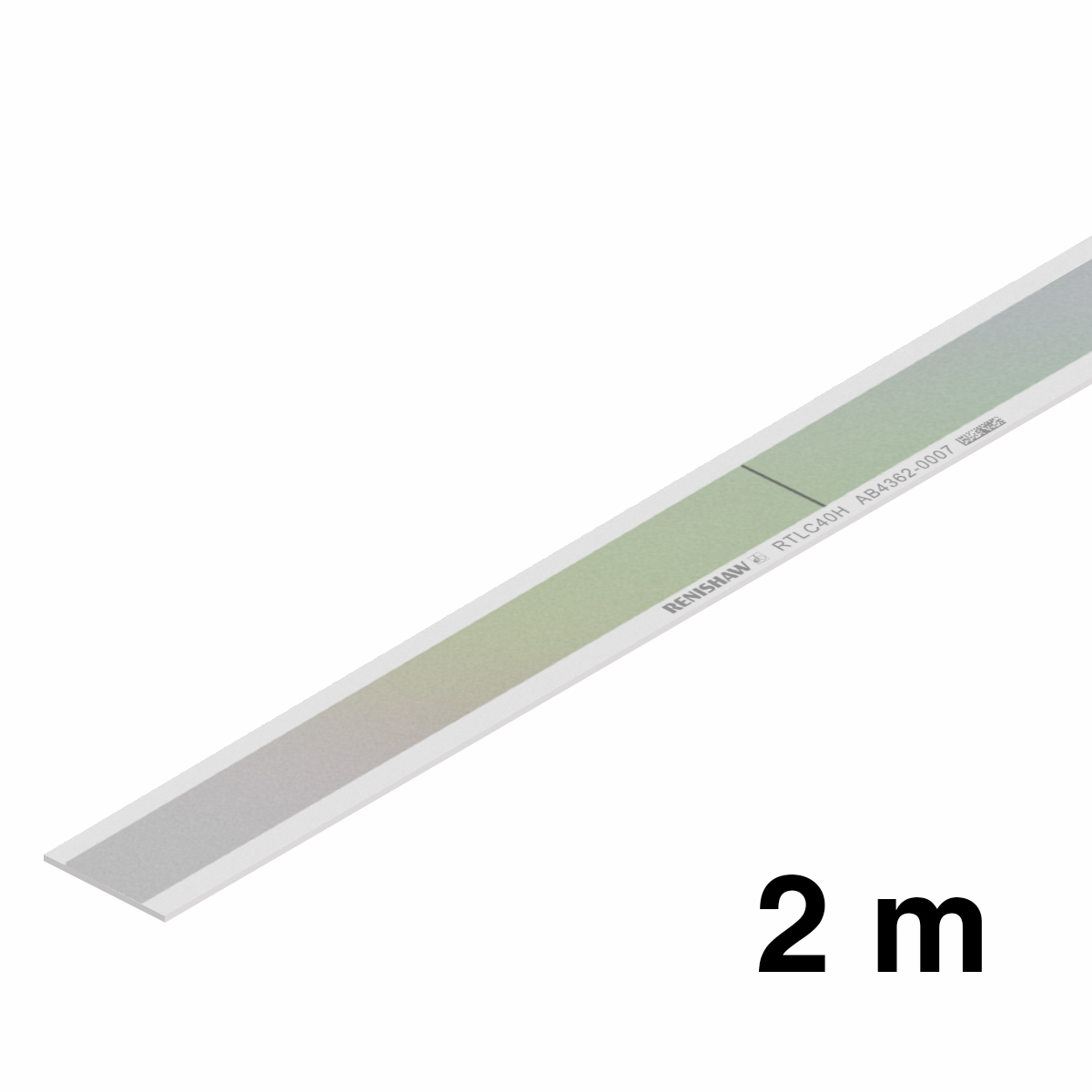

A-6670-0200 is a 2 m (2000 mm) length of RTLC40H-S (high accuracy version of RTLC40-S) incremental encoder tape scale, compatible with QUANTiC encoder readheads.
RTLC40H-S is a 40 µm pitch low-profile stainless steel tape scale.
RTLC40H-S is applied to the substrate with self-adhesive backing tape, which is formulated to enable the scale to expand independently of the machine substrate. To complete the installation, the scale is clamped at one point to provide a datum position.
Technical table
Accuracy (± µm)5
Coefficient of thermal expansion10.1 µm/m/°C
Length (mm)2000
MaterialStainless steel
Mount typeSubstrate independent
Scale length (m)2000
Scale pitch (µm)40
Scale type8 mm wide x 0.2 mm thick flexible stainless steel tape (CTE: 10.1 ±0.2 μm/m/°C)
