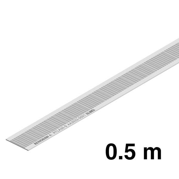

RTLA30-S linear encoder tape scale (30 µm scale pitch, for RESOLUTE™ readheads) Product code: A-9763-0050 RTLA30-S 0.5 mNo description available[0B] RTLA30-S 0.5 m No description available [0B] Price: $319.00 All prices are ex sales tax Limited AvailabilityLonger lead times may apply.Contact us for more information. Add to new group Before you begin to add items to your favourites please create your first group: A favourites group name can only be 1-80 alphanumeric characters and must not begin with white space Product sucessfully added to View favourites Processing request A-9763-0050 is a 0.5 m (500 mm) length of RTLA30-S absolute encoder tape scale, compatible with RESOLUTE encoder readheads.RTLA30-S is a 30 µm pitch low-profile stainless steel tape scale.RTLA30-S is applied to the substrate with self-adhesive backing tape, which is formulated to enable the scale to expand independently of the machine substrate. To complete the installation, the scale is clamped at one point to provide a datum position. Technical tableCoefficient of thermal expansion10.1 µm/m/°CLength (mm)500MaterialStainless steelMount typeSubstrate independentScale length (m)500Scale pitch (µm)30Scale typeTape RTLA30-S Features / Benefits:Quick and simple application using Renishaw's scale applicator Low-profile stainless steel tape scaleHigh solvent immunityCut-to-length flexibility Compatible readheads: RESOLUTEAvailable online:RESOLUTE RL32BBT050B30ARESOLUTE RL32BBT050B30FRESOLUTE RL26BBT050B30FRESOLUTE RL26BBT050B30A For more details on this and other Renishaw encoder scales please visit our scales page Related products $23.00 IPA wipes for all encoder system installations (pack of 20) $14.00 Datum clamp for adhesive mounted RTL linear encoder tape scales $25.00 Scale end covers for RTL encoder scales $422.00 Guillotine for cutting RKL and RTL linear encoder scales $37.00 Scale applicator for RTLA self-adhesive scales with RESOLUTE™ or EVOLUTE™ encoder readheads $191.00 Shears for cutting RKL and RTL linear encoder scales $26.00 LOCTITE® 435 adhesive (20-gram bottle) $67.00 Replacement blades for scale shears $34.00 Dispensing tip for LOCTITE® 435 adhesive (pack of 50) Shopping security Recall your cart
