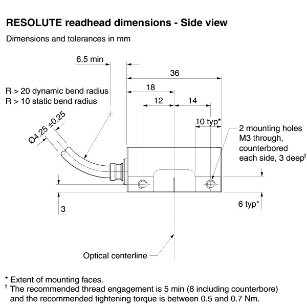

RL26BBT050B30A Key Features / Benefits:
  • RL26BBT050B30A is suitable for RTLA30 scale lengths up to 3.355 m and is IP64 sealed for high reliability in harsh environments
  • RL26BBT050B30A, when used with RTLA30 scale, is compatible with FASTRACK carrier system for low hysteresis applications and installations that require regular disassembly (contact your local Renishaw representative)
  • RL26BBT050B30A features <10 nm RMS jitter for improved positional stability and excellent motion control
About the RESOLUTE true-absolute encoder series
  • Ultra-low SDE and jitter give class-leading linear encoder performance
  • Integral set-up LED for simple installation and calibration
  • CAD model of the RESOLUTE readhead is available from the Renishaw website
