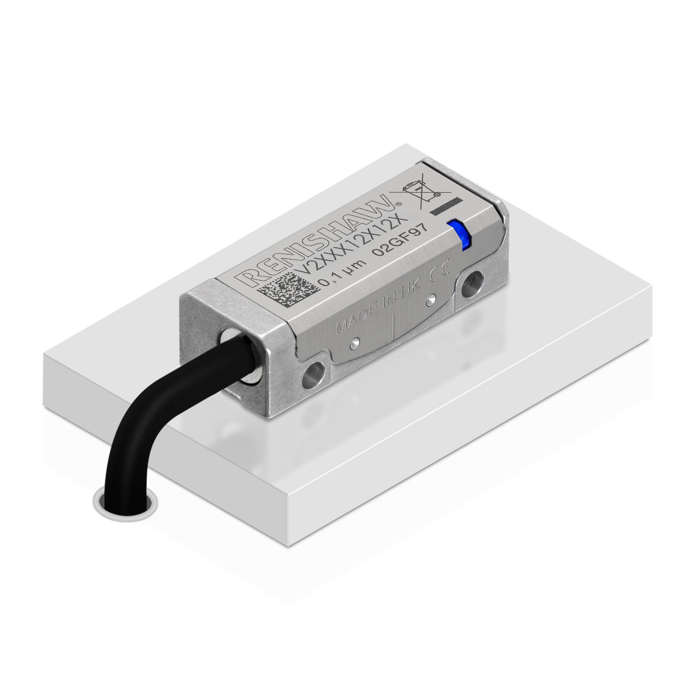

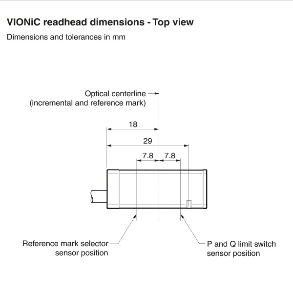

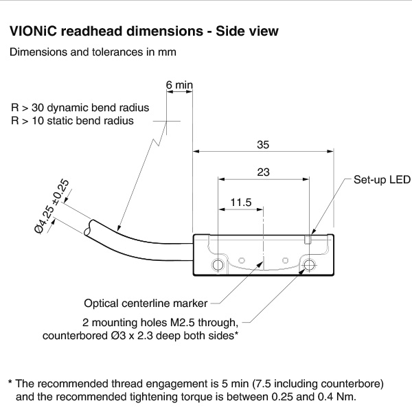

VIONiC™ readhead for rotary encoder diameters 60 mm to 135 mm (0.1 µm resolution, 20 MHz clocked output) Product code: V2CKY30D20F VIONiC incremental encoder on a white plinthNo description available[0B] VIONiC incremental encoder on a white plinth No description available [0B] Dimension drawing of VIONiC readhead - top view Dimension drawing of VIONiC readhead - top view [0B] Dimension drawing of VIONiC readhead - side view Dimension drawing of VIONiC readhead - side view [0B] Dimension drawing of VIONiC readhead - end view Dimension drawing of VIONiC readhead - end view [0B] Price: $909.00 All prices are ex sales tax Stocked itemNormally dispatched within 2 working days Add to new group Before you begin to add items to your favourites please create your first group: A favourites group name can only be 1-80 alphanumeric characters and must not begin with white space Product sucessfully added to View favourites Processing request V2BJY30D20F is a standard Renishaw VIONiC readhead with a 3 m cable length. This readhead is configured for rotary encoder system using RESM20 rings with outer diameters of between 60 mm and 135 mm. The VIONiC incremental encoder readhead, when combined with the RESM20 ring, offers highly reliable digital position feedback for superior metrology, smooth motion control due to low sub-divisional error (SDE), and high axis speeds. Technical tableCable length (m)3Cable termination15-way D-type connectorClocked output frequency (MHz)20Maximum speed (m/s)1.61Readhead termination15-way D-type connectorReadhead typeIncremental digital RS422Resolution (µm)0.1Scale pitch (µm)20Sub-divisional error<±20 nm V2CKY30D20F Key Features / Benefits: V2CKY30D20F rotary encoder is compatible with RESM20 rings (diameters 60 mm to 135 mm) V2CKY30D20F features a reference mark and a 3-state alarm output V2CKY30D20F features a highly dynamic 3 m cable with a 15-way D-type connector cable termination (standard pin out) V2CKY30D20F requires a controller input frequency of at least 20 MHz About the VIONiC series of super-compact digital encoders: Renishaw’s highest performing incremental optical encoder is easy to install with wide set-up tolerances and simple calibration VIONiC readheads combine Renishaw's market proven filtering optics, dynamic signal control and advanced interpolation technology. This provides ultra‑low SDE, excellent dirt immunity, and eliminates the need for separate interfaces An optional Advanced Diagnostic Tool ADTi-100 (A-6195-0100) is available for real‑time encoder data feedback during installation or for in-field diagnostics A CAD model of the VIONiC readhead is available from the Renishaw website Compatible scales: RESM20 Available online: RESM20USA075RESM20USA100RESM20USA115 Related products $434.00 ADTi-100 (Advanced diagnostic tool) for VIONiC, QUANTiC and ATOM DX incremental readheads $87.00 Adaptor cable kit 'A' for ADTi-100 (Advanced diagnostic tool) $12.00 USB cable for ADTi-100 and ADTa-100 (Advanced diagnostic tool) $15.00 P limit actuator magnet for TONiC™, VIONiC™ and QUANTiC™ linear encoder readheads $15.00 Q limit actuator magnet for TONiC™, VIONiC™ and QUANTiC™ linear encoder readheads $15.00 Reference mark selector magnet for RTLC and RKLC encoder scale installation $11.00 Magnet Applicator Device for RTLC and RKLC encoder scales $1.00 Readhead setting shim for TONiC™, VIONiC™ and QUANTiC™ encoder readhead installation Shopping security Recall your cart
