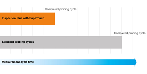

Minimise cycle time
SupaTouch makes intelligent in-process decisions to deliver significant improvements in cycle time based on the capability of the machine tool.

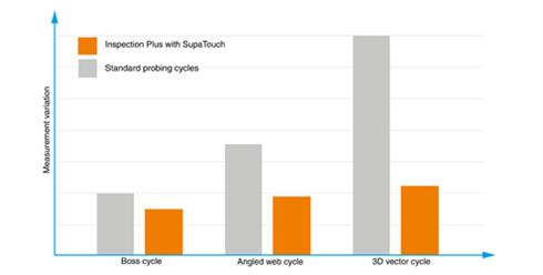

Improved metrology
Inspection Plus with SupaTouch technology significantly improves metrology.
Ability to distinguish between the real and electronic probe length (length when triggered). This provides a significant advantage when using 3D vector probing cycles as it ensures the probe is correctly positioned for each measurement.
Accurate metrology in all directions is made possible by automated, 'on-the-fly' calculation of the stylus ball radius for every measurement move.
Measurements taken in the probe acceleration and deceleration zones are remeasured at a constant velocity to ensure accurate metrology.
From simple prismatic to more complex 3D cycles, Inspection Plus with SupaTouch can improve accuracy and repeatability in all directions. The image below illustrates typical improvements that can be achieved.
