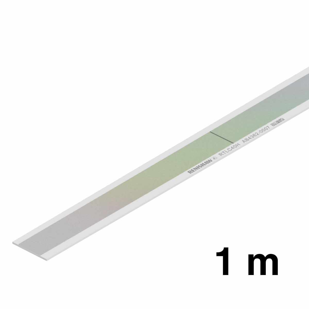

A-6670-0100 is a 1 m (1000 mm) length of RTLC40H-S (high accuracy version of RTLC40-S) incremental encoder tape scale, compatible with QUANTiC encoder readheads.
RTLC40H-S is a 40 µm pitch low-profile stainless steel tape scale.
RTLC40H-S is applied to the substrate with self-adhesive backing tape, which is formulated to enable the scale to expand independently of the machine substrate. To complete the installation, the scale is clamped at one point to provide a datum position.
