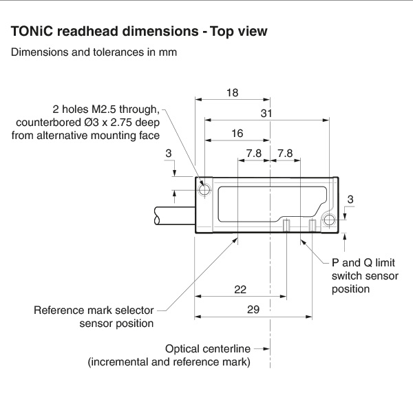

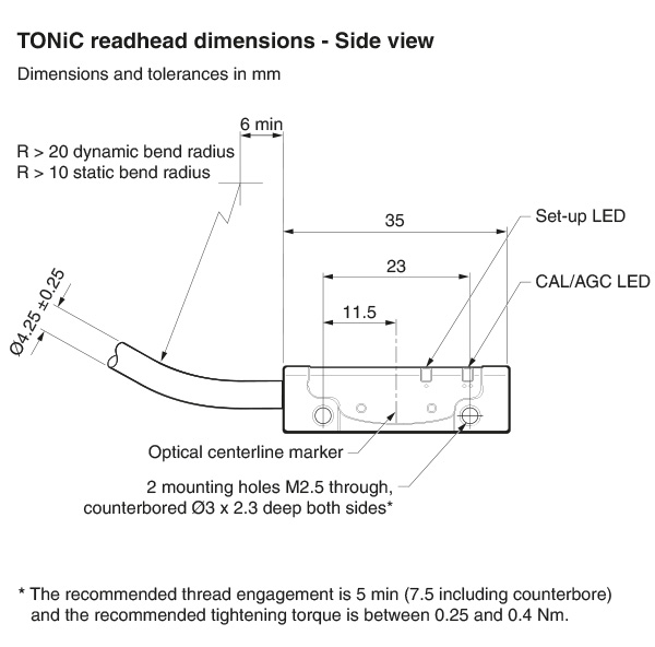

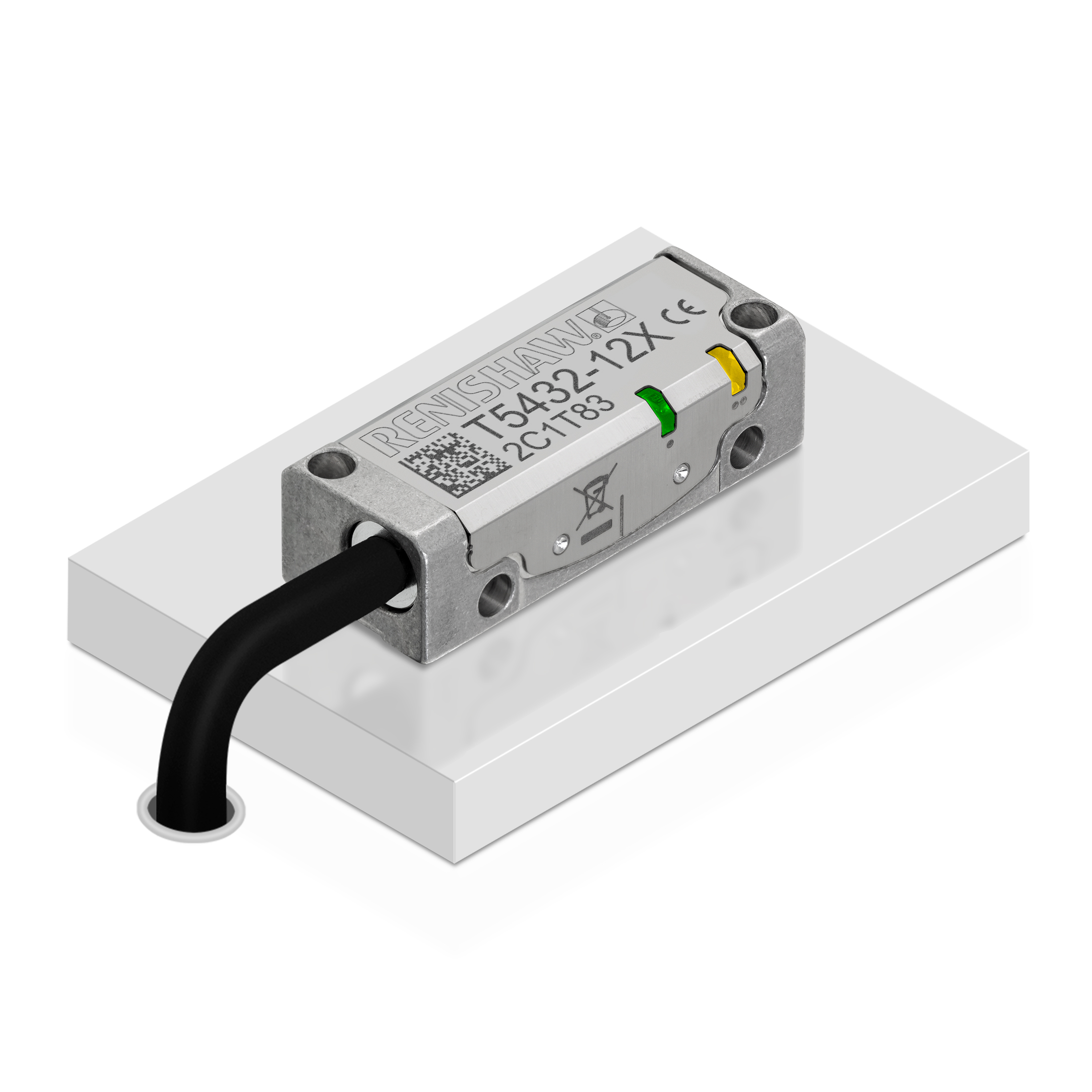

T2011-15A is a standard Renishaw TONiC readhead with a 1.5 m cable length. This readhead is configured for rotary encoder systems using RESM20 rings with outer diameters of between 60 mm and 135 mm.
When combined with the detachable Ti interface Ti0000A00A, it provides ultimately reliable precision feedback and high-speed performance, with easy installation, analogue output, low sub-divisional error (SDE) and noise.
Technical table
Cable length (m)1.5
Maximum speed (m/s)10 m/s at -3 dB
Readhead terminationInterboard connector
Readhead typeIncremental analogue 1 Vpp
Scale pitch (µm)20
Sub-divisional error<±30 nm typical
T2011-15A Key Features / Benefits:
  • T2011-15A is compatible with RESM20 rings (diameters 60 mm to 135 mm)
  • T2011-15A features a reference mark output
  • T2011-15A features a 1.5 m cable with a termination for connection to a Renishaw TONiC interface
  • T2011-15A is compatible with analogue TONiC interface Ti0000A00A
